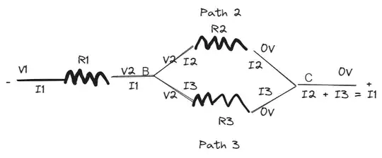

If you combine series and parallel paths, then you need to use the bullet points I gave above to figure out what's going on. You need to put R, I, and V labels on all your known and unknown quantities, as shown in the diagram below.
series + parallel
We know that the current I2 in path 2 = V2/R2. We know that the current I3 in path 3 = V2/R3. We know that adding these two currents gives us the total current seen at point C on the circuit: V2/R2 + V2/R3 = V2/RP = I1, where RP is the effective resistance between points B and C. So, the effective resistance is the inverse of (1/R2 + 1/R3.)
Therefore the total resistance of the circuit is R1 + inv(1/R2 + 1/R3), and so current I1 = V1/(R1 + inv(1/R2 + 1/R3)).
Once we know I1, we can calculate currents I2 and I3, and the voltage drops produced by each of the resistors. We don't know these until we have the total current on the circuit.
