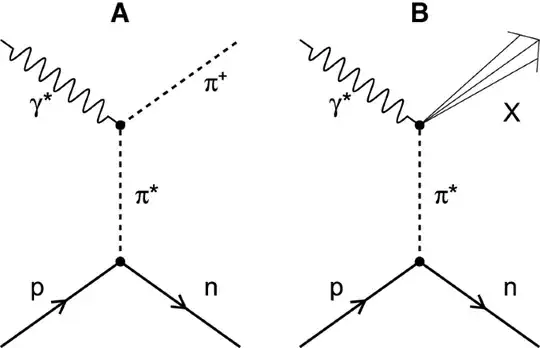

The Electron-Ion Collider (EIC) with an acceptance optimized for forward physics has the potential for accessing pion and kaon structure functions over a large kinematic region through the Sullivan process, where one measures the contribution to the electron Deep Inelastic Scattering (DIS) of the meson cloud of a proton target: the nucleon parton distributions contain a component which can be attributed to the meson cloud. enter image description here
  • Sullivan processes. In these examples, a nucleon’s pion cloud is used to provide access to the pion’s (a) elastic form factor and (b) parton distribution functions. $t = (k − k′)^2$ is a Mandelstam variable and the intermediate pion, $π^∗(P = k − k′)$, $P^2 = t$, is off-shell.
