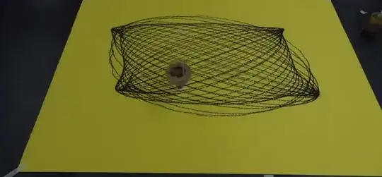

A simple pendulum (where the bob is a sand tank or an ink can) when oscillated in 2 planes simultaneously (suppose East West plane and North South plane), it leaves a pattern figure on ground. To my surprise, in some cases this figure is a Rosette (Like hypotrochoid flowers drawn using spirograph) or like a precision orbit, but whereas in some cases it is Lissajous figure.
Example : Rosette:
This youtube link of ink cans
ink can rosette
and
Lissajous figures:
This sand pendulum on youtube
Sand pendulum lissajous
To my surprise: what factors cause one situation to print a rosette and in another situation to produce a Lissajous? Are these two curves same? is it possible that in some special conditions (Ratio etc) one changes into the other?
They are closely related.
A rosette combines two motions. One motion is a simple circle. The other adds a radial oscillation to it. This comes from a sand pendulum suspended from a point. If you swing it in a circle, it draws a circle. If you bump it so it also swings in and out. It draws a rosette.
A spirograph does something very similar. It adds a circular motion on a circular motion. This answer to How does the Coriolis effect explain Ekman transport? happened to come up today. For a very simple elliptical rosette, it shows why circle on circle is equivalent to radial line on circle.
A Lissajous pattern combines two motions. One is a linear oscillation in the x direction. The other is a linear oscillation in the y direction. This requires the two string support shown in the video. If you swing the sand pendulum in the x direction. It draws a line back and forth. If you bump it in the y direction, it draws a Lissajous pattern.

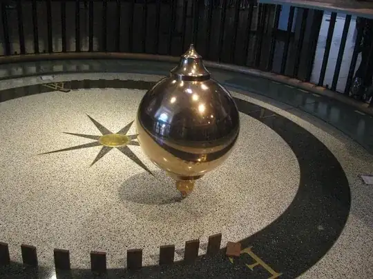

Note that in both cases, the video shows the pendulum slowing down and drawing smaller and smaller patterns. To draw a true rosette or Lissajous, you would need to keep nudging the pendulum to overcome friction. The San Diego Museum of Natural History has a Foucault pendulum. See this and this
The sphere is about a foot in diameter. It is suspended from a point a few stories up. A simplified explanation is that it swings back and forth in a line, and the earth turns under it. That is how it would work at the north pole. It is a little more complicated at San Diego's latitude. The result is that a complete rosette comes every 44 hours or so instead of every 24 hours.
The disk in the floor has an electromagnet in it. It nudges the pendulum to keep it moving.
