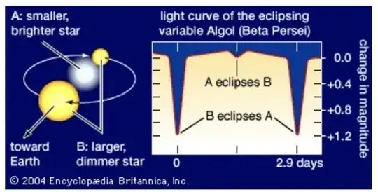

An example of a light source casting a shadow is found in eclipsing binary stars. As the stars rotate around each other, the shadow of star A cast by the light of star B sweeps through space (and vice versa). When that shadow (temporarily) includes Earth, we see a dimming of the light because we're only getting light from one of the stars. This can be thought of as though star A is casting a shadow on us, blocking the light we'd normally get from star B.
enter image description here Graphic from Encyclopedia Britannica

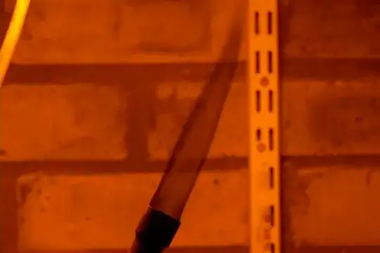

A flame can have a clear shadow under special circumstances. It makes a great classroom demo in a Modern Physics class.
Take an atomic emission light source. Sounds tricky, but sodium vapour lamps are very common, both as lab equipment and as some street lights. So lets use sodium.
Turn on your sodium vapour lamp and let it warm up to full brightness.
Next, light a bunsen burner or propane torch. Place it between the lamp and a white screen. The flame will be nearly invisible, and will not cast a shadow.
Now, spray some salt water as a mist into the flame.
Two things will happen. The flame will turn the same yellow colour as the lamp, because the heat of the flame is exciting the sodium in the flame to emit the exact same spectrum as the sodium in the lamp.The flame will add some yellow light to the lamp's light on the screen.
But the flame will also cast a shadow on the screen! The unexcited atoms of sodium in the flame will absorb the exact matching sodium light from the lamp. The flame will block some of the light from the lamp from reaching the screen: the very definition of a shadow.
Here's an illustration: enter image description here
from the article at https://www.thenakedscientists.com/get-naked/experiments/dark-flames#:~:text=Sodium%20gas%20is%20very%20very,making%20the%20flame%20look%20dark.
