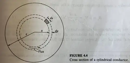

The authors of Power Systems Analysis calculate the inductance per unit length (henrys/meter) of a transmission line attributed only to the flux inside the conductor as "flux linkages per ampere." The flux is drawn in the x-y plane (i.e., in the page). Is the flux linkage also in the x-y plane?
"In the tubular element of thickness $dx$" the flux per meter of length is $d\phi$. "The flux linkages $d\lambda$ per meter of length, which are caused by the flux in the tubular element, are the product of the flux per meter of length and the fraction of the current linked" (p149): \begin{align} \mathrm{d\lambda}=\frac{πx^2}{πr^2}{d\phi} \end{align} What is the direction of $d\lambda$? Given that the flux is directed concentrically (as shown in the figure), is the corresponding flux linkage also directed concentrically in the cross section of the conductor?
Note: The figure above assumes uniform distribution of current throughout the cross section (p145).

Basically, the term "flux linkage" is an idea in circuits and more of an engineering aid. The actual field lines and flux for a particular surface (which must be defined before one can integrate) are the more physical ideas.
Full disclosure, the second sentence says [citation needed] in that article, so it may be a bit of a point of controversy. The article definitely needs improving, but my understanding is consistent with it. I checked a few more places and everyone refers to linkage in terms of wires, so this seems to be the norm.
The interior magnetic field in a conducting wire does lead to observed effects of course, and those will be predicted at the very least by Maxwell's equations and the Lorentz force law. There may be a way to define "equivalent flux linkage" for a wire and simplify the analysis, I'm not sure. I have never seen this and am skeptical of it.
There is a bit of technical point here. Since the $\vec{E}$ field is no longer irrotational when there is a time varying $\vec{B}$ field, the "total voltage" is no longer path independent. This is why you get a concept like flux linkage. It is the path enforced by the wires, with a highly conductive path and highly resistive boundaries, that lead to a particular "total voltage" or "EMF" as it can be called:
$$ EMF = \oint \vec{E} \cdot d\vec{r} $$
I personally don't like the whole EMF thing and just think of it as voltage. Anyway, in the interior of a conductor, the path of the contour integral is not defined, so I don't know how a "flux linkage" would be defined. The behavior of the fields will be predicted by solving Maxwell's equations in a material.
