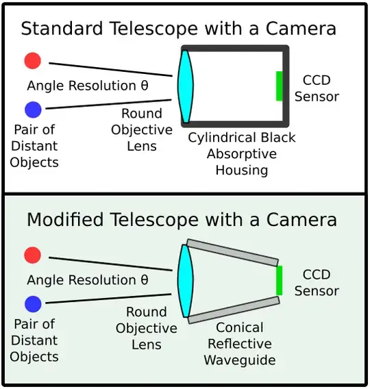

As an engineer that knows just enough physics to be dangerous, I was thinking, could this be applied after the primary objective lens in a telescope to reduce the effects of diffraction? See my rough diagram below. I realize that this would induce other potentially worse issues by picking up off-angle images; but just for the sake of understanding, would this conical waveguide reduce the diffraction impact on the angular resolution of the image?

A "waveguide" is a homogeneous structure that has its own modes of propagation. As long as the modes do not meet a discontinuity in the waveguide they do not diffract from their being normal modes. Huygens' principle holds all the way through so that the elementary wavelets of the wavefront of the mode whose sum is the mode always add up to be the normal mode until a discontinuity is met at which point they "diffract" and distort the mode.
Free space is also a waveguide whose own modes, those that have all its sources and sinks, the singularities, are at infinity, are the TEM plane waves. Huygens' principle is a superposition principle by which we decompose the TEM modes having singularities at infinity now to be represented as a sum (integral) in which the singularities (sources) are placed here on the wavefront.
The first discontinuity we are speaking of is the front rim of the the cylinder holding the lens at which they diffract. Those diffracted waves are "lost" for anything you can do within the cylinder, they are not in the telescope because they diffracted at the rim to the outside in every possible direction.
Now you may ask if those diffracted wavelets on the outside could be collected and thereby improving the resolution of your telescope. I believe some can be collected but then all you are doing is increasing the effective phase coherent receiving area. But ultimately you will always collect with a finite size that itself will act as the limit to your "diffraction limit".
There are also wavelets that diffract off the rim internally towards the lens but to collect them separately you have to induce more diffracting objects inside and those will also cause diffraction, etc.,
In short, you cannot receive and infinite size wave with a finite size instrument without causing a reconstruction error. This answer is related to your question.
