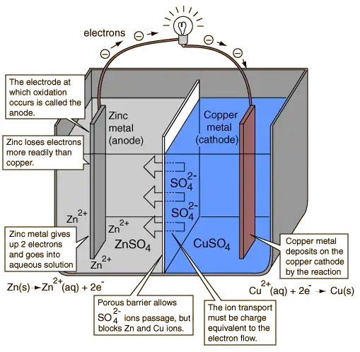

I think this picture answers the question: CuZn battery
The battery's terminals are not charged. It's just a chemical reaction that starts the charge.
There's a $\text{Zn}$ and a $\text{CuSO}_4$. When they meet each other via a cable, the $\text{Zn}$ gives 2 electrons to $\text{CuSO}_4$ and becomes $\text{Zn}^{2+}$.
$\text{Cu}^{2+}$ of $\text{CuSO}_4$ becomes $\text{Cu}$ and becomes electrostatically neutral, and separates from $\text{SO}_4^{2-}$.
Then we have $\text{SO}_4$ with -2 charge and $\text{Zn}$ with +2 charge. So, $\text{SO}_4^{2-}$ moves to $\text{Zn}^{2+}$ to get bound to each other.
In the end, we have $\text{ZnSO}_4$ and $\text{Cu}$.
With two different batteries, it's not possible. The $\text{SO}_4^{2-}$ has nowhere to go and make new connections. Thus the chemical and electrical process doesn't start.
