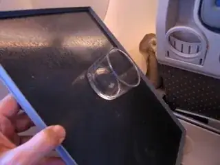

The wikipedia page on friction mentions that silicone rubber or acrylic rubber-coated surfaces have a coefficient of friction that can be substantially larger than 1. Meal trays in Singapore Airlines probably deploy such rubber and are reported to have a coefficient of friction greater than 1 when in contact with almost any object (note the slope exceeding 45° in below picture).
To accelerate a wheel driven object faster than $g$, I suggest you try four-wheel drive and acrylic rubber-coated wheels. A radio-controlled model car would do as a proof-of-principle.
