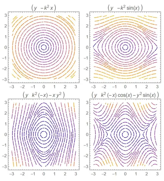

By drawing a phase plot you can more visually see where the approximations are valid. Define \begin{align} x&\equiv \theta\\ y&\equiv\dot\theta \end{align} This transforms your initial equation into the following first order differential equations: \begin{align} \pmatrix{\dot x\\\dot y}=\pmatrix{y\\-y^2\sin x-k^2x\cos x} \end{align} We can plot the vector on the right as a velocity field to see the dynamics. You are probably familiar with this. I use the following Mathematica code to do this:

I added the small angle approximation of the harmonic oscillator as well for comparison.
My interpretation: as long as $x$ and $y$ are both small the approximation is valid. The region of validity is fairly small though and outside the unit circle the approximation becomes pretty bad. The valid region will probably change for different $k$.
