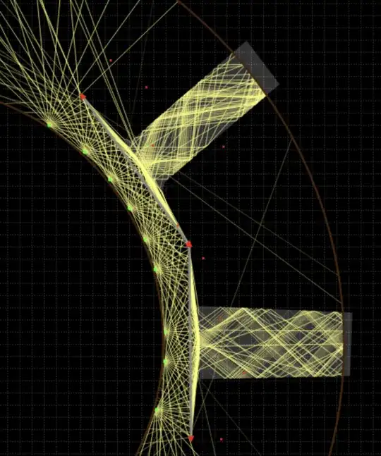

As an honest citizen, I do not intend to violate the laws of thermodynamics by concentrating the light emitted by a blackbody on a smaller area. However by playing with this wonderful 2d ray online simulator and inserting this json I get this result:

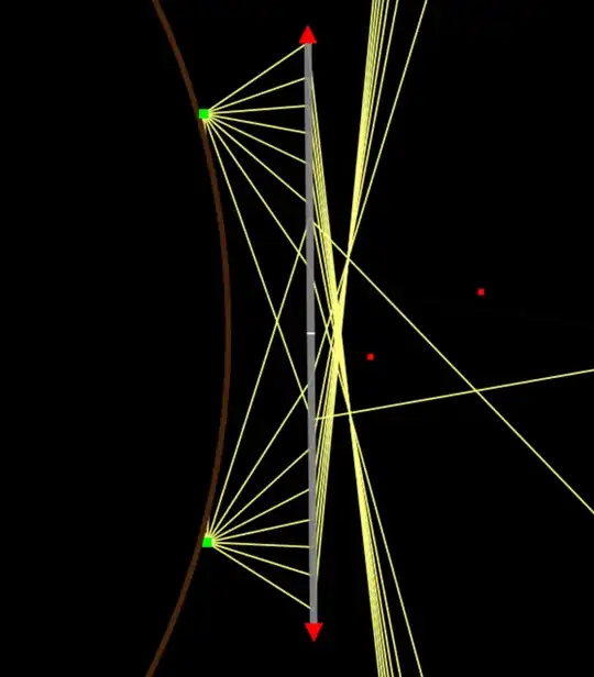

You can see that I have tried to simulate the diffuse emission of a spherical blackbody with these 180 degrees point sources placed around a spherical light absorber. I have placed two ideal lenses of very high concentration (I guess you could manufacture these lenses as fresnel lenses, or maybe not and that's the point), and as you can see I now have a colimated beam of higher light concentration inside my lightpipes, with which I would be able to heat a target to higher temperature than the blackbody.
I do not think I violate the law of conservation of etendue as etendue is conserved in my system. I have read as well these posts about this subject, but I couldn't figure out why their answer would rule out this contraption.

So my question is: Why is this not possible? What is the issue with my simulation?
