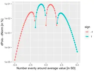

So, let's calculate the difference of the two densities for $\lambda = 100$. This is what the following picture shows:

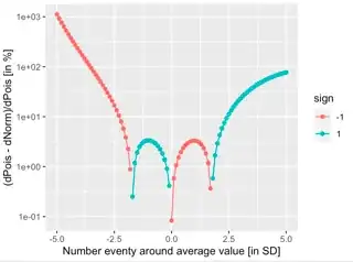

On the y axis I plot the difference of the two densities, and on the x axis I first remove the average value $\lambda$ -- so that the average value is shifted to zero --, and then I divide by the standard deviation $\sqrt{\lambda}$ -- so that we see that the x values span from $\bar x \pm 5 \cdot SD$. We see that the absolute error is smallest in the tails of the distribution, and largest around the average value. However, in the tails both distributions are extremely small. Therefore, it is informative to plot the relative error as well. This is done in the following graph:
The shifting and scaling is done analogously. Now we see that the relative error is large in the tails of the distribution and it is smallest around the average value. This is why we can not answer your question about the severity of the approximation in general, but the answer must be: The severity depends on the details of your question.
