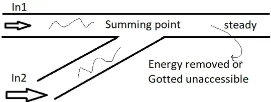

Assume the picture below:
schmatic
From inlet port In1 and In2 we can have electromagnetic or acoustic energy entrace single sine wave with same amplitude and frequency. Assume we have aligned the waves to completely destroy each other After two wave summing in summing point (assume summing point has been created approximately perfect with no reflection). Then we sense zero energy after summing point, where the waves have steady state. This rejects energy conservation since it means we after that "summing point steady state output", we will never be able to access that energy. Then have removed some energy from our word at least apparently, though in theory the still present and is bounded together.
What is wrong on my argument? Maybe energy conservation is just applicable for masses and not the waves? I'm electrical engineer and not the physician sorry for weak physical understanding.
I've heard collision of particles can create positive and negative particles, like matter and anti-matter.

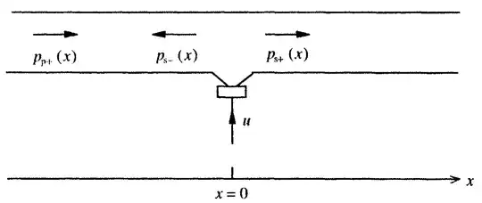

Now, I will use a simpler system than the one you provide and then extend to what you have shown in your image. So, below you see an equivalent system (source: ”Signal Processing for Active Control” by Steven Elliot)
1D Active Noise Control problem
In the image, we see three propagating waves where $p_{p+} \left( x \right)$ is the “noise” (I’ll use this term to denote the signal we care to cancel, in the literature this is found as the primary source) propagating on the positive $x$ direction, $p_{s+} \left( x \right)$ and $p_{s-} \left( x \right)$ waves which are the propagating waves in the positive and negative directions respectively due to the “control” source (in the literature this is found as secondary source).
Note that $u$ is the signal of the “control” source and it is in the same frequency $\omega$ (hence same wavenumber $k$) as the “noise” source signal. The waves due to the “control” signal can be written as
$$ \begin{align} p_{s+} \left( x \right) = B e^{-j k x}, ~~~ x > 0 \tag{3.a} \label{3.a}\\ p_{s-} \left( x \right) = B e^{+j k x}, ~~~ x < 0 \tag{3.b} \label{3.b} \end{align}$$
where again here $B$ is the amplitude of the waves.
The condition we want to impose is
$$ p_{p+} \left( x \right) + p_{s+} \left( x \right) = 0 \implies p_{s+} \left( x \right) = -p_{p+} \left( x \right) \implies B e^{-j k x} = -A e^{-j k x} \implies B = -A \tag{4} \label{4} $$
By setting the amplitude of the “control” source waves equal to the negative of the “noise” wave we can achieve perfect (in theory only) noise reduction downstream.
Now, what about upstream, towards the direction of the “noise” source? Well, we can calculate the resulting sound field as the summation of the two fields in this region. This is
$$ p_{p+} \left( x \right) + p_{s-} \left( x \right) = A e^{-j k x} - A e^{+j k x} = -A \left( e^{j k x} - e^{-j k x} \right) = -2 j A \sin \left(k x \right) \tag{5} \label{5} $$
where in the last step the known equality $e^{j x} - e^{-j x} = 2 j \sin \left( x \right)$ has been used. Notice that equation \eqref{5} describes a standing wave, which is the superposition of a positive-going with a negative-going wave. The nodes (pressure nodes in this case) are at $x = 0, \frac{\lambda}{2}, \lambda, \ldots, n \frac{\lambda}{2}, ~~~ n \in \mathbb{N}$ (this is where the function $\sin \left( k x \right)$ is zero). Similarly, at positions $x = \frac{\lambda}{4}, \frac{3 \lambda}{4}, \ldots, \frac{\left(2 n + 1 \right) \lambda}{4}, ~~~ n \in \mathbb{N}$ the amplitude of the resulting wave is $2 A$.
Thus, the energy that was moving towards the right (positive $x$ direction) has now been diverted to the left (negative $x$ direction). This constitutes a realisation of the energy conservation principle.
Extention to your problem
Please note that the above situation is completely equivalent to your system. That is because the phenomena at the junction (you describe it as the ”Summing point”) are exactly the same as those described in the previous section (Derivation) if we assume (lossless) plane wave propagation in an infinite domain. The back-propagating wave from the “control” source you mention is not part of the system and thus it plays absolutely no role in the conservation of energy in the system. The energy in this other system (the propagation of the “back-propagating” wave of the “control” source) is conserved by definition since there are no other sources and the system is lossless by definition.
