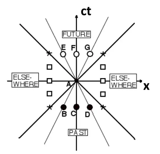

The picture below (Figure from Exploring Black Holes by Taylor, Wheeler & Bertschinger) illustrates these ideas. There is an event at A, with events B-G plotted in the same diagram. The future and past light cones are labelled. Events E, F, and G are in the future light cone of A. Events B, C, and D are in the past light cone of A.
Light cones
If the interval $ds^2$ between two events is negative then these events could be causally connected, because one lies in the future light cone of the other. This is known as a timelike interval. If the interval is negative, it is called spacelike and the two events cannot be causally connected. That is, something at event A can influence, signal to or even travel to event E, but cannot influence or travel to event B, or any of the unlabelled events marked with squares in the "elsewhere" region, because they are not inside the future light cone of A.

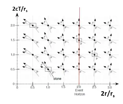

The light cones corresponding to this eqution are plotted below (Figure adapted from Exploring Black Holes by Taylor, Wheeler & Bertschinger), where $r_s = 2GM/c^2$, the event horizon (where $r=r_s$ is marked with a red line and the future and past light cones are marked with an F and a P and are calculated according to the equation for $cdT/dr$ given above.
Light cones in G-P coordinates
The key point in this diagram, that answers the question posed here, is that at $r=r_s$, the light cones are defined by $$\frac{dT}{dr} = -0.5\ \ \ {\rm for\ ingoing\ light}\ , $$ $$\frac{dT}{dr} = \infty\ \ \ {\rm for\ outgoing\ light}\ .$$ And if $r<r_s$ then it is not possible for $dT/dr$ to be positive.
What this means is once at $r<r_s$, the light cones tip over towards decreasing $r$ and all future events inside the future light cones are at smaller values of $r$. Thus no signals can be sent to larger $r$ and even a light beam that is directed outwardly will in fact move towards a smaller value of $r$.
