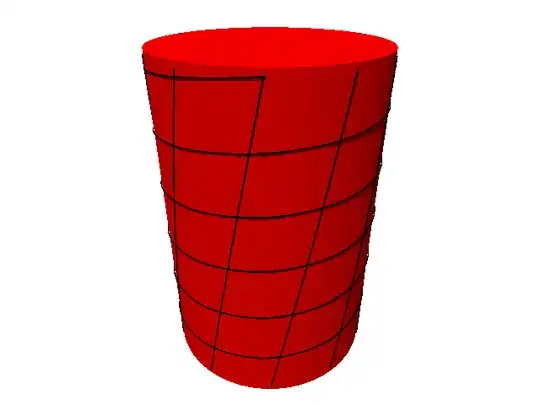

Rotating disc
In the diagram, time is vertical and space is horizontal (in the reference frame of a static observer). At each point on the circumference of the disc, local space and time axes for the rotating observer are drawn, so they join up. Because it is moving, the space and time axes are both tilted, by a Lorentz transformation. The time axis being tilted means it advances in time as you follow the circumference around, not meeting up with itself. The length of this loop is different, and as it happens, shorter. As you get faster and approach light speed, both coordinates approach $45^\circ$ and get shorter, due to length contraction. But the volume of spacetime they trace out remains exactly inside the same cylinder of a stationary disc, and besides motion blur, will look exactly the same shape to an observer.
$\pi$ doesn't change. It doesn't require any weird hyperbolic geometry (as some sources have suggested) to understand.
