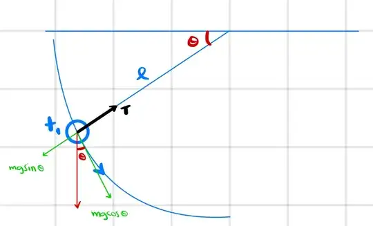

Consider a pendulum of mass $m$ and length $l$, released from rest in a horizontal position. At some time $t_1>t_0=0$, the situation looks like the following

However, what I'd like to do is compute the change in linear momentum using impulse by considering my system to be just the mass. Tension on the pendulum string and gravitational force are thus external to the system, and an impulse by these forces should give us the change in momentum of the mass.
$$\int_{t_0}^{t_1} F^{ext}(t)dt=\int_{t_0}^{t_1} \left [ (mg\sin{\theta(t)}-T)\hat{r}+mg\cos{\theta(t)}\hat{\theta} \right ]dt$$
Note that $\hat{r}$ and $\hat{\theta}$ are functions of $t$, and we know the functional form because we can express these vectors in the Cartesian basis using $\theta(t)$.
$$\int_{t_0}^{t_1} F^{ext}(t)dt=\int_{t_0}^{t_1} \left [ (mg\sin{\theta(t)}-T(t))(-\cos{\theta(t)}\hat{i}-\sin{\theta(t)}\hat{j})+mg\cos{\theta(t)}(\sin{\theta(t)}\hat{i}-\cos{\theta(t)}\hat{j}) \right ]dt$$
$$=\int_{t_0}^{t_1} T(t)\cos{\theta(t)}dt\ \hat{i}+\int_{t_0}^{t_1} [T(t)\sin{\theta(t)}-mg]dt\ \hat{j}\tag{1}$$
$$=\Delta p = m\vec{v(t_1)}$$
We don't know what $\theta(t)$ and $T(t)$ are at this point, however, so we can't integrate.

$(1)$ $U(t_{1})=mg(l-lsin\theta)$ not $U(t_{1})=mg(l-lcos\theta)$ .$(2)$ yes. $(3)$ write tension as a function of $\theta$ and see if you can solve the integro-differential equation that comes (you can't(without approximation) unless you've seen elliptic function such as Jacobi or Legendre or Series expansions, but since you're computing i think you can find a solution with numerical methods trough python or other.
