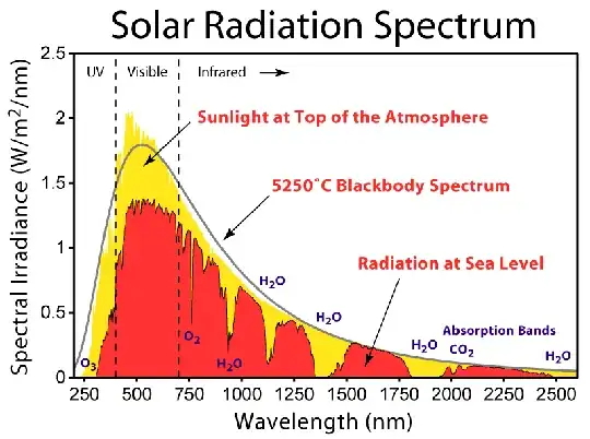

In space, the sun transfers heat via radiation to equipment and astronauts. Although the sun’s peak emission is in the visible region (about 500 nm), you can see that there is also a fair amount of IR (infrared) and UV (ultraviolet) emitted as well at the top of the atmosphere.
