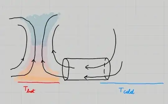

Some points need to be clarified here. Despite the very details of turbulence are not fully understood yet, anyway we can say something about the qualitative or the average motion of fluids even when turbulence occurs.
  1. The video linked in your answer can be explained by buoyancy. It can be related to the mechanisms of (in)stability in fluids and macroscopic motion of the flow, more than turbulence.

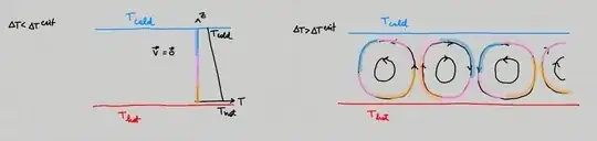

    Let's start with a toy problem, with a fluid confined between two horizontal planes at different temperatures, with warmer temperature on the bottom wall:
    • when the temperature jump is lower than a critical value, a temperature gradient is established in the fluid, without any motion; this situation corresponds to a stable equilibrium of the system;
    • when the temperature jump exceeds that critical value, first instability occurs; the equilibrium loses its stability and convective cells appears in the fluid: in some regions of the flow close to the bottom wall, the fluid is warmer and less dense that the surrounding fluid, and it tends to move upwards by buoyancy; as the fluid approaches the top low-T wall, the temperature of the fluid particle decreases; now, denser than before and the surrounding regions, the fluid particle tends to move downwards towards the high-T bottom wall; passing close to the bottom wall, the fluid particles absorbs heat again, its temperature increases and its density decreases and it's ready to move upwards again by buoyancy.
    The very same mechanism occurs here: upwards motion over the hot vessel, sucking air from the surrounding regions. I suspect also that the vessel with ice is quite irrelevant to the problem, or at least it has a "higher order effect".

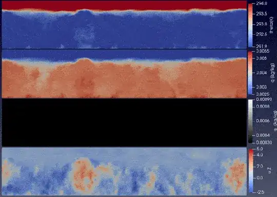

Turbulence can also be caused by thermal convection even if there is no mean horizontal wind at all. Thermal convection develops when thermal stratification becomes unstable due to positive heat flux from the warm surface. Unfortunately, in a compressible fluid (like the air) the situation is complicated by the compressibility and one must look at the profiles of the potential temperature and not temperature. In a well-mixed atmosphere the potential temperature is constant, but the temperature decreases by one degree of Celsius by every 100 m of height. The result of convection are rising thermals and plumes of warm air in which birds and glider aircraft like to soar. Wind gusts may be well caused by the thermally-produced turbulence.
enter image description here This shows my simulation of thermal convection in the atmosphere with shallow clouds. No mean wind, just thermal turbulence. Potential temperature, moisture, liquid water, vertical velocity.
