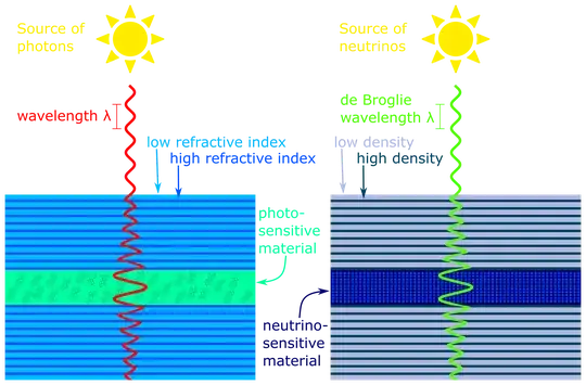

The interaction between light and matter can be enhanced by trapping the light in an optical cavity. In a short Google research I didn't find an experiment trying to enhance neutrino-matter interaction in this way. Is it just impractical? If yes, why? The situation with light and neutrinos should be quite similar: Light coming from a distant source of photons arrives with plane wavefronts on earth. If we want to enhance the interaction of let's say some molecules with light of a specific wavelength $\color{#ff0000}{\lambda}$ we send it into a Fabry-Pérot cavity of length $m/2 \cdot \color{#ff0000}{\lambda}$ with $m \in \mathbb{N}$. The mirrors are distributed Bragg reflectors (DBRs) consisting of alternating layers with high $\color{#0050ff}{n_h}$ and low refractive index $\color{#00b8ff}{n_l}$, each with an optical thickness of a quarter wavelength $\color{#0084ff}{n} d = \color{#ff0000}{\lambda} / 4$. The reflection at a single refractive index boundary is small (given by Fresnel equations), but the interference between the partial reflections allows reflectivities of > 99.999%. The light is then concentrated between the mirrors and can interact efficiently with material which by itself would have a small interaction cross-section.
In the case of neutrinos the DBRs would be made of alternating layers of high $\color{#00415b}{\rho_h}$ and low density $\color{#aeb8df}{\rho_l}$ material. One can even define an equivalent refractive index $${\color{#577c9d}{n_i}}^2 = \left( \color{#51ff00}{\lambda} / \color{#51ff00}{\lambda}_\color{#577c9d}{i} \right)^2$$ (see Eq. 5.1 in [1]) with the de Broglie wavelength $\color{#51ff00}{\lambda}$ in free space and $\color{#51ff00}{\lambda}_\color{#577c9d}{i}$ in medium $\color{#577c9d}{i}$. Similar to when light hits a refractive index boundary, a part of the neutrino wavefunction is coherently scattered into the backwards direction at each interface. Adding up the amplitudes of all partial reflections increases the reflectivity of such a DBR. [2] proposes a lock-in measurement to detect the momentum transfer from reflecting a stream of neutrinos off a DBR. In that paper, they specifically talk about neutrinos with particularly long de Broglie wavelengths using DBRs with layer thicknesses around $a \approx 30\,\text{cm}$, but the thin film technology has substantially improved since then, so that one could work with layer thicknesses of tens of nanometers.
Where does the idea of cavity-enhanced neutrino detection go wrong? Or is it simply that a cavity would constrain the wavevector of the neutrinos too much, since they need to come from the right direction with the right wavelength?
