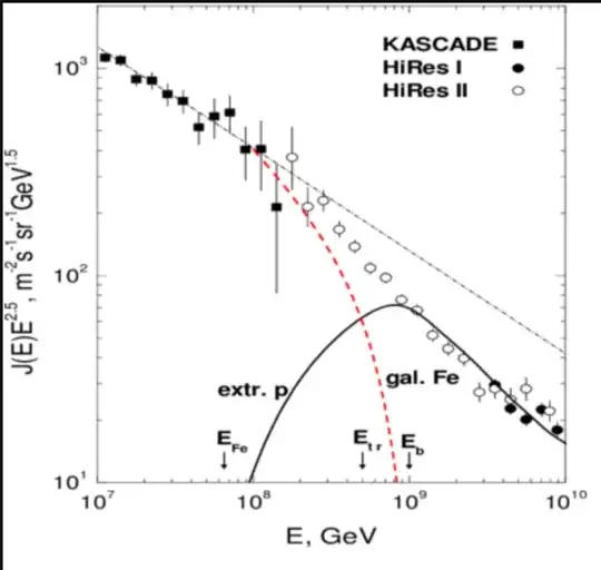

For instance, the image below, adapted from arXiv:0204357, shows how the spectrum of the differing population generate the knee. The red curve shows the galactic portion of CR iron ions while the black line shows the extra-galactic portion of CR protons combining together to form the whole spectrum.
Hence, the only thing that should impact the location of the knee is the energy spectrum of the particles themselves, which is going to depend on the source accelerating them.
