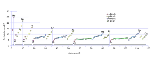

It's not that simple. Binding energies depends on $\mathcal Z$ number and also on particular electron configuration, as per chart :
