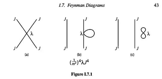

Yes, OP is right. OP's term (1) [which corresponds to Fig. I.7.1c] together with e.g.
$$\sum_n(A^{-1})_{in}(A^{-1})_{nn}(A^{-1})_{nj}(A^{-1})_{kl} \tag{2}$$
[which corresponds to Fig. I.7.1b] are in principle also there. [This is mentioned 2 paragraphs below eq. (I.7.10) in the 2nd edition.] Such terms correspond to diagrams with self-loops.
$\uparrow$ Fig. I.7.1 (Source: Ref. 1.)
