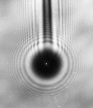

The below is from http://minerva.union.edu/jonesc/scientific_photos%202010.htm :
"In 1818, Fresnel presented his theory explaining diffraction of light. Poisson denied the truth of the theory, and argued that a consequence of the theory would be that there would be a bright spot right in the middle of the shadow of a circular object. The spot, shown above of the shadow of a ball bearing suspended on a needle, was promptly discovered by Arago. This was a lot harder to do before lasers were invented!"
Note: observation of such diffraction patterns are best done in (nearly) monochromatic light. Hence the remark about using lasers. The bright spot at the center of a circular shadow is known as an Arago spot.
