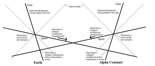

The situation is even worse than that! In relativity, there is no universal definition of 'instantaneous' - it varies depending on your velocity. So the following situation can arise, where both measurements collapse the wavefunction of the other before the other measurement can occur.
Both measurements collapse the wavefunction before the other
The resolution of the paradox is that wavefunction collapse has no observable consequences, and indeed there is an interpretation of quantum mechanics (the Everett Interpretation) where no collapse takes place, and nothing propagates 'instantaneously' or faster than light. (See here for a longer discussion.)
Since the wavefunction collapse version makes exactly the same experimental predictions as a theory in which nothing travels instantaneously or faster than light, the collapse can have no observable instantaneous/FTL consequences. Long distance correlations arise, but they are only observable once the experimenters have got back together (at sub-lightspeed) to compare notes.
The fundamental problem here is the concept of wavefunction collapse, which does not work well with relativity. Quantum mechanics without collapse works fine with relativity. Although the Schrodinger equation is non-relativistic, the Dirac equation (that governs the motion of particles like electrons) is perfectly valid relativistic quantum mechanics.
