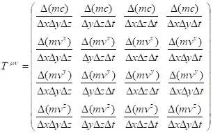

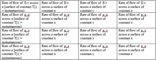

The definition of $T_{\mu\nu}$ is “the rate of flow of the $\mu$ component of four-momentum across a surface [of unit area] of constant $\nu$.” Since the four-momentum’s terms are ($E/c$, $p_x$, $p_y$, $p_z$), by this definition, this creates the following matrix :
Which can be reduced to a shorthand units notation of (note : $mc = E/c$ = momentum) :

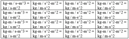

And doing a units analysis on this results in :
The 3 right columns all have the correct units, because of the $\Delta$t in their denominator in the second matrix. But the left column’s denominators are all spatial, so the units are not an energy density or momentum flux.

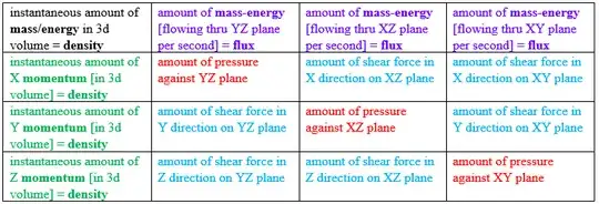

Also, why is the tensor claimed to be symmetrical, when the left column’s units are different than the top row’s units? Even if I have the left column wrong, the shear forces (see table below) are also not symmetrical.
P.S. – since pressure’s units are : $kg/m~s^2$ and shear force’s units are : $kg~m/s^2~m^2 = kg / m~s^2$, the first matrix can be re-written (using the dimensions of the second matrix as a guide) as :
Which is the best description I’ve seen for this tensor.
