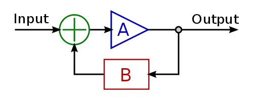

Let's model the situation with $A$ representing the combination of the microphone, amplifier and loudspeaker, and the effect of the sound traveling through the air from the loudspeaker back to the microphone as $B$. In general $A(\omega)$ will be a function of the frequency $\omega$, and will be almost linear until the output signal gets to be large enough that it gets "clipped". That is, $A$ behaves as a complex multiplier where the magnitude of $A$ is the amplification and the angle of $A$ is the phase shift.
$B$ also behaves linearly, and depends mostly on the distance $r$ of the microphone from the loudspeaker. The signal will travel through the air at the speed of sound (~340m/s), and so there will be a delay of $\frac{r}{340\mathrm{m/s}}$, and $B$ will attenuate the signal by some factor, let's say $1/r^2$. Here's the public domain picture from wikimedia commons:
System diagram for feedback
If the input is $x(t)$ and the output is $y(t)$ then we get $ y=A(x+By) $ or $$ y(t) = \frac{A}{1-AB} x(t)\mathrm{.} $$
Oscillations occur when $AB = 1$ (exactly). That means that the attenuation from $B$ is equal to the amplification by $A$ (including clipping) and the phase shift of traveling distance $r$ exactly cancels the phase shift from the amplifier.

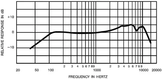

Look at the frequency response for the Shure SM58 microphone (a popular and widely used voice microphone). It looks like this:
Shure SM58 frequency response
Most guitar amps look similar. dB is a logarithmic scale, usually $20 \log_{10}\frac{p}{p_\mathrm{ref}}$ so 5dB is about 1.8x and 10dB is 3.2x. Some harmonic in that range between about 3KHz and 8KHz is probably going to dominate.
