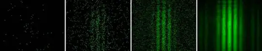

Single photon wavefunctions can add coherently to produce a classical wave depending on the boundary conditions of the problem. In my view, the difference between individual photons and the classical light wave becomes clear with this experiment I discuss here..
snglph
Single-photon camera recording of photons from a double slit illuminated by very weak laser light. Left to right: single frame, superposition of 200, 1’000, and 500’000 frames.
On the left, the photons seem random, in the accumukation the classical wavefront behavior becomes clear.
In a similar way, I hand wave, the geometrical constraints of the problem "charged particle faster than light in medium" allow for the "random" photons from the molecular activity to add up to a coherent wave.
