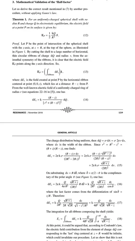

Below I have attached a picture of an article claiming that the result is actually $\frac{kq}{2R^2}$. Now I am really confused since untill this day I knew it to be $\frac{kq}{R^2}$ but didn't know the proof. Kindly clear this confusion.

Where does "the surface" starts and ends going from the center to the outside? Does a shell of zero thickness really exists? So, I think you have to consider a "limit" condition with r > R and tends to R (R+). I also read that article, basically if it works or not :) it's a useful exercise of logic. In the real life you can deal with potential and electric field very very close to the surface, but not exactly at distance 0 from the shell of 0 thickness. :) [EDITED] Also, if we consider the "surface" like a shell of some Angstrom thickness, we should assume that for a "point" test charge the Electric field right oh that shell is very variable due to the distance among the test charge position and effectiive charge particle on the shell: in that way we sould consider an "average value" on the entire surface.
