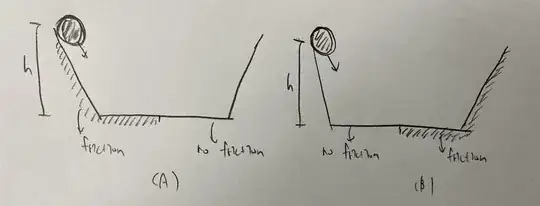

There are two fixed inclined plane as shown above. In situation (A), there are frictions on the left side. The right side of the inclined plane is frictionless. In situation (B), the right side of the inclied plane are frictionless. There is friction on the left side. (Like the picture below)
Both the situation A and B, A rigid ball starts from the left side of the inclined plane. The initial velocity is 0.
If you calculate, the maximum height that the ball goes in situation A and B is both $ \frac{h}{1+\beta}$ where the rotational inertia of the ball is $\beta mr^2$. (It does not depends on the friction constant $\mu$) The fact that the height is the same at A and B really interests me.
With a little calculation, you can figure it out but I want qualitative reason why the maximum heights are the same at A and B.

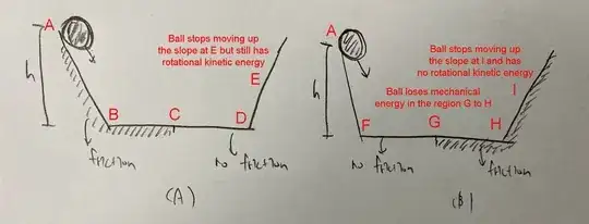

If the ball is rolling without slipping the frictional force does no work as there is no relative movement at the point of contact between the ball and the surface.
For the left-hand situation mechanical energy is conserved.
The ball starts from rest at $A$ and gains both rotational and translational kinetic energy as it loses gravitational potential energy with no work done by friction as there is no slipping.
At $B$, $mgh = \frac 12 mv^2 + \frac 12 \beta mr^2 \omega^2$ and $v=r\omega$.
From $B$ to $C$ the frictional force does no work and so the ball continues to $D$ at constant total (translational and rotational) kinetic energy, indeed the frictional force is zero in this phase of the balls motion.
From $D$ to $E$ the rotational speed of the ball cannot change as there is no frictional or any any other force about its centre of mass to apply a torque on it. Thus the only change in mechanical energy is that of the translational kinetic energy being converted into gravitational potential energy.
At $E$ the ball ceases any translational motion but is still rotating about its centre of mass and so has rotational kinetic energy. Thus $mgh' = \frac 12 mv^2 \Rightarrow h'=\frac {h}{1+ \beta}$
The situation is different for the right-hand situation where the is a region where mechanical energy is not conserved.
From $A$ to $F$ the ball falls gaining only translational kinetic energy, $mgh = \frac 12 m u^2$ and note that $u>v$.
From $F$ to $G$ the ball is not rotating and has constant speed, $u$, and constant translational kinetic energy, $\frac 12 mu^2$.
When the ball arrives at $G$ the ball is not rotating and so there must be relative movement between the ball and the surface so kinetic friction, $f_{\rm k}= \mu_{\rm k}mg$, must be acting.
The kinetic friction will be in the opposite direction of the motion of the ball to reduce its translational speed whilst at the same time apply a torque about the centre of mass of the ball to increase the rotational speed of the ball.
This will continue until the no slip condition is satisfied with $u' = r\omega'$.
So after $G$ the kinetic frictional force is doing reducing the mechanical energy of the ball.
If the time to reach the no slipping condition is $t$ then using the ideas of impulsive force and impulsive torque $f_{\rm k}\,t = mu-mu'$ and $f_{\rm k}\,r\,t = \beta mr^2\omega -0'\Rightarrow u' = \frac {u}{1+\beta}$.
After reaching $H$ the ball gains gravitational potential energy and loses both rotational and translational kinetic energy until it reaches a height $h''$ where is stops both translational and rotational motion.
$mgh'' = \frac 12 \beta mr^2 \omega'^2 + \frac 12 m u'^2$ with $u' = r \omega'$ which then produces the result $h'' = \frac{h}{1+\beta}$, the same height as in the left-hand situation.
So the mechanical energy lost in the right-hand situation is equal to the rotational kinetic energy the ball had when it stopped translational motion in the left-hand situation.
Static friction does play a part in both situations but in the right-hand situation there is also kinetic friction acting for a part of the motion.
It is interesting to note that the magnitude of the kinetic frictional force does not affect the final result; if it is large the time taken from pure translation to translation and rotation is small and that occurs over a shorter distance as compared with the kinetic frictional force being small so that the transition time is now larger and the distance over which the transition occurs is also larger.
However the work done by the kinetic frictional force, frictional force $\times$ distance during which the transition occurs, stay the same!
