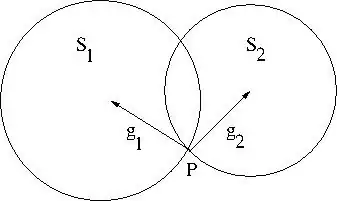

Imagine that we are at point $P$ in a homogeneous, isotropic Universe. Point $P$ is on the surface of a sphere $S_1$ with mass $M_1$ and radius $R_1$. Therefore, in Newtonian terms, there is an acceleration $g_1$ at point $P$ directed towards the center of sphere $S_1$ with magnitude:
$$g_1=-\frac{G M_1}{R_1^2}.$$
But point P is simultaneously on the surface of a sphere $S_2$ with mass $M_2$ and radius $R_2$. Therefore one can construct another argument, independently of the previous one, that there is an acceleration $g_2$ at point $P$ directed towards the center of sphere $S_2$ with magnitude:
$$g_2=-\frac{G M_2}{R_2^2}.$$
However since the Universe is homogeneous and isotropic then, again in Newtonian terms, there should not be any net acceleration vector at any point.
How do we resolve this paradox?
Either the Universe is empty so that $g_1=g_2=M_1=M_2=0$ or General Relativity gives us another solution.

(1) The first part of the question presents a paradox in Newtonian gravity. The resolution of the paradox is that solutions to the Poisson equation are only unique for certain specific types of boundary conditions, and those don't include the boundary conditions being discussed here. See this question for more discussion.
(2) The second part of the question includes some ingredients from GR but isn't a fully general-relativistic treatment. Its result is correct if stated as follows: cosmological expansion is linear if and only if the equation of state is $w=p/\rho=-1/3$, where $w$ represents an average over all sources including dark energy and the units are such that $c=1$. This follows directly from the Friedmann equations.
So this particular presentation isn't very compelling, since 1 is a mistake, and 2 is only of interest if 1 holds.
