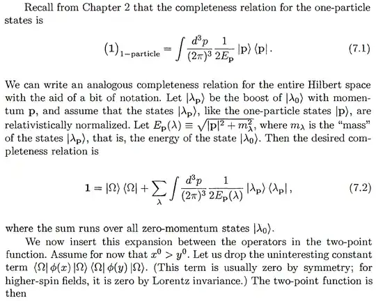

A short question, when I am studying QFT-P&S's book, try to use completeness relation (7.2) to expand the two-point correlation function: $$\langle\Omega|\hat T{\phi(x)\phi(y)}|\Omega\rangle\tag{7.3}$$ in to (7.3), P&S say:
the term $\langle\Omega|\phi(x)|\Omega\rangle$ & $\langle\Omega| \phi(y)|\Omega\rangle$(or for spin half field: $\langle\Omega|\psi(x)|\Omega\rangle$ & $\langle\Omega|\bar \psi(y)|\Omega\rangle$) are usually zero by symmetry; for higher-spin field it's zero by Lorentz invariance.
My question is, know how to prove this claim? (both for $\phi$ and $\psi$)
This is the original P&S book: (P. 212)
