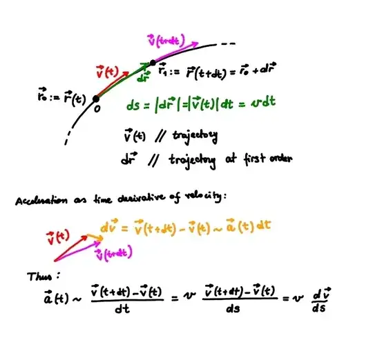

In vector form, you may think the position of point $P$ as $\mathbf{r}_P(t)$, its velocity $\mathbf{v}_P(t)$, and its acceleration $\mathbf{a}_P(t)$.
Method 1. If you define the velocity as a function of the position of the particle $\mathbf{v}_P(t) = \mathbf{v}(\mathbf{r}_P(t))$, you can evaluate the time derivative of this function as
$\dfrac{d}{dt}\mathbf{v}_P(t) = \dfrac{d}{dt} \mathbf{v}(\mathbf{r}_P(t)) = \dfrac{d v_{P,i}}{dt} = \dfrac{\partial v_i}{\partial x_j} \dfrac{dx_j}{dt} = v_j \dfrac{\partial v_i}{\partial x_j} = \mathbf{v}_P(t) \cdot \nabla\mathbf{v}(\mathbf{r}_P(t))$,
being $\mathbf{v}_P \cdot \nabla$ the directional derivative in the direction of $\mathbf{v}_P$ multiplied by the magnitude of the velocity $v_P = |\mathbf{v}_P|$,
$\dfrac{d}{dt}\mathbf{v}_P(t) = v_P(t) \mathbf{\hat{t}}(\mathbf{r}_P(t)) \cdot \nabla\mathbf{v}(\mathbf{r}_P(t))$,
being $\mathbf{\hat{t}}$ the unit vector, tangent to the trajectory.
It's important to understand the meaning and to be able to handle the directional derivative to avoid the evaluation of the gradient of the velocity $\mathbf{v}$, since the velocity $\mathbf{v}_P$ of the particle is only defined along the trajectory.
Thus, with the trajectory paramterized with its arc-length parameter $s$, $\tilde{\mathbf{r}}_P(s) = \mathbf{r}_P(t)$ the last equation reads
$\dfrac{d\mathbf{v}_P}{dt} = v_P \dfrac{d}{ds} \mathbf{v}(\tilde{\mathbf{r}}_P(s))$.
Method 2. We could have found the very same equation introducing the parametrization of the trajectory with its arc-length parameter $s$, $\mathbf{r}_P(t) = \tilde{\mathbf{r}}_P(s) = \tilde{\mathbf{r}}_P(s(t))$ and performing the derivative of the composite function $\mathbf{v}_P(t) = \mathbf{v}_P(s(t))$, as
$\dfrac{d \mathbf{v}_P}{dt} = \dfrac{d s}{dt} \dfrac{d \mathbf{v}_P}{ds} = v_P \dfrac{d \mathbf{v}_P}{ds}$,
being the magnitude of the velocity $v_P = \frac{ds}{dt}$ by definition of the arc-length parameter.
