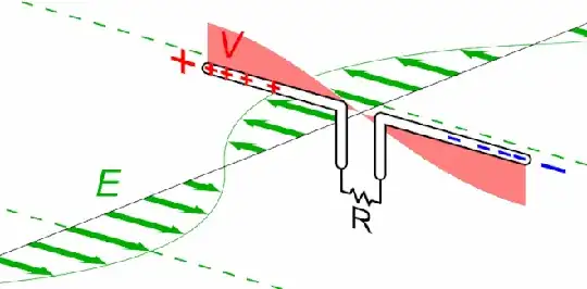

As far as I can tell, this mistake derives from the common simple explanation of dipole radiation:
When the charges are separated, the E-field is maximum. $\pi/2$ later, the charges are moving through the dipole antenna and are at maximum current: max B-field.
This is true; however, if look at the dipole radiation formula you will see that this term is multiplied by $1/r^n$ with $n>2$: it does not radiate; it is near field.
The term that goes as $1/r^2$ (in power) is the radiation term, and it has E and B in phase.
