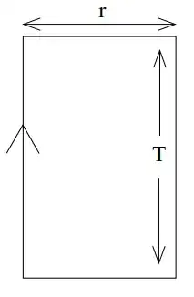

Now consider the specific closed loop C shown in the figure. We again take this to sit in the fundamental representation. It has the interpretation that we create a quark antiquark pair, separated by a distance r, at some time in the past. These then propagate forward for time T, before they annihilate back to the vacuum.

Then Tong says something crucial which I don't understand:
In the presence of the sources, the ground state of the system has energy $V(r)$.
My confusion isn't about the specific form of $V(r)$ or anything like that; I just don't know what the words in the above sentence are meant to mean.
If we were studying a scalar field, say, I'd have no issue. In that case, "in the presence of sources" would mean "insert some $\exp(\int J(x)\phi(x))$ into the path integral". For our specific scenario we'd take something like $J(x)=\delta(\vec{x})+\delta(\vec{x}-\vec{r})$, representing static sources at $\vec{0}$ and $\vec{r}$. Then "the ground state of the system has energy $V(r)$" means that if we include the sources in the Lagrangian, then the resulting Hamltonian $H_J$ has ground state energy $V(r)$. We can compute $V(r)$ perturbatively, with the leading order given in terms of the tree propagator.
In Yang-Mills, such interpretations are unavailable. Gauge invariant operator insertions are given by Wilson loops, not source terms of the form $\int J(x)\phi(x)$. Moreover, the Wilson loop only exists "as a whole"; it doesn't make sense to take a slice of time and ask what the Hamiltonian is in the presence of that Wilson loop. So I don't know what "ground state energy in the presence of sources" means here, let alone how to calculate it.
