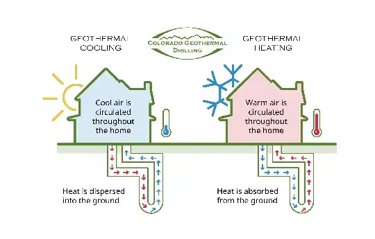

So there are two different things here.
Shallow geothermal cooling
The first is your animation from “Colorado Geothermal Drilling”. This is a long thin hole that goes maybe 100 meters into the ground with a U-shaped tube in it, and water circulates through that tube. So I take issue with, say, Agnius’s diagram above because you can't even see this depth on the diagram, literally one four-thousandth of the distance to the first mark where the lithosphere ends.
The way this works is much simpler than that... It is just that the thick rocks of Earth’s crust, filled with liquid water and such, are dense, they take a loooot of heat energy just to change a little in temperature. The atmosphere is not so dense, and so you get these big temperature swings in the air from summer to winter. And the very top layer of the ground feels some of that too, but as you dig deeper you get further into the rock and the groundwater and all this “thermal inertia” that keeps a constant pleasant temperature.
It's the same basic reason why people store wine in the basement, or why bears go into caves for winter, or why many animals burrow underground rather than migrating. The deeper you go the more predictable it is, “At this depth it is 10°C (50°F) and it stays that temperature all year round.” And when you pipe water down and back up, no matter what temperature of the water goes down with, it exchanges heat with the vast amounts of rock and comes back up at that fixed stable temperature of the rock.
The easiest thing you could do with the water is, just pump it through your walls as-is. It would keep your house at around that same temperature, the 10°C is warmer than the freezing temperatures outside during the winter, but cooler than the sweltering temperatures of summer. Your entire house become this one big cool wine-basement. In practice people prefer a slightly warmer temperature though, and more control, so they use a little electricity to power what's called a heat pump. I won't get too deep into those work because you didn't ask, but the basic idea is that in winter heat wants to flow out of this 10°C water into the freezing air, maybe if we help it flow out then we can get more heat per unit of electricity, than if we just dump that electrical straight into heat energy (say with a space heater). This means that some very cold water will be coming out of the heat pump after we are done with it, but we send that water down into the Earth and it comes back at 10°C again so we don't have to worry about it.
So that is how to use the constant temperature 100m under the ground to heat a house in winter and cool it in summer.

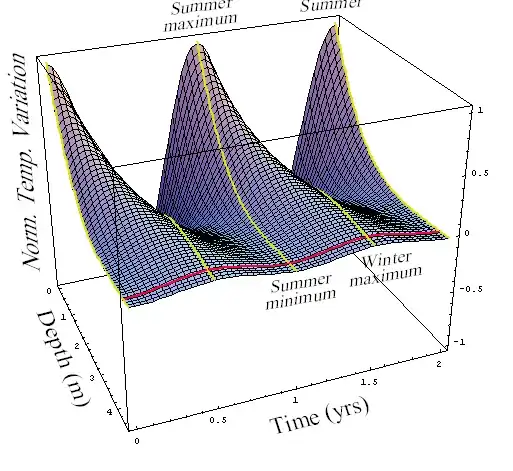

Simplified solution for a single harmonic
To simplify things, we can limit the analysis to a single harmonic component of the surface Fourier series by hypothesizing that during a sidereal revolution, the variation in temperature linked to the tilt of the Earth with respect to the plane of the orbit can be approximated by a single sinusoid with a period of one year. It's coldest in the middle of the winter, then it gradually becomes warmer, it's hottest in the middle of the summer and so on... For this yearly variation in temperature, Sommerfeld finds that at a depth of about 4 meters in average soil, the phase lag is 180 degrees and the attenuation is 1/16.
A more recent treatment was given by G. C. Berresford ("Differential Equations and Root Cellars", UMAP Journal 2 (1981), pp. 53-75) who focused on the annual variation alone, deriving the following simplified expression for the normalized sinusoidal temperature change:
$$ T(x,t) = \cos(2 \pi t - k x) \exp(-k x) $$
where x is the depth in meters, t is the time in years and k is the attenuation/propagation constant that, for the annual periodic variation in 'average soil', has the value 0.743224 (m^-1).
The harmonic seasonal temperature perturbation at the surface propagates in the terrain at a speed of 8.45 meters per year, and the first 'phase inversion' happens at a depth of 4.23 meters, a result in good agreement with Sommerfeld's approximate computation. This inversion of minima and maxima is the reason why cellars are particularly lukewarm in the winter and cool in the summer.
graph of phase-shifted sinusoidal surface
In the winter, the ground at 'cellar depth' is 'optimally hot' because it is 'remembering' or better 'belatedly experiencing' the hot of the summer (albeit quite a bit 'faded' due to the exponential attenuation). Vice-versa, in the summer the cellar goes through the (attenuated) cold peak of the previous winter.
The deeper you go the more you reach an average temperature which, despite being constant, still happens to be warmer than the cold winter temperatures, and cooler than the hot summer ones. At a depth of about 20 meters, the seasonal oscillations in surface temperature are no longer appreciable and the temperature of the soil is roughly the yearly average of the temperature at the surface.

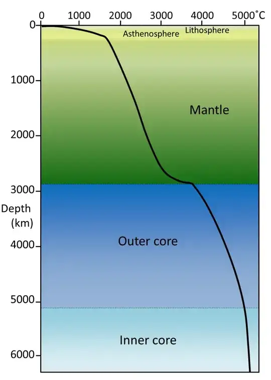

Because in principle our Earth is a heat generator (like a "wood stove"). Check Geothermal gradient:
(Image credits, here.)
and you'll see that Earth inner core has temperature about $5000~^\circ \text{C}$, so basically answer is that it warms inner-ground of surface. In case surface is heated more than natural geothermal gradient predicts (by sun, fire place, etc), then surface becomes an additional heat absorber, because heat always flows from warmer to colder places. Hence this is answer to second part of your question.
BTW, greatest geothermal gradient is within first $100~km$ of depth which is about
$$ \left( \frac {\partial T}{\partial z} \right)_{100~km} \approx 20 ~^{\circ} \text{C/km}.$$ Hot geysers in the Iceland are due to the local bigger geothermal gradient, which happens because of higher volcanic activity and other heat exchange mechanisms in that area.
