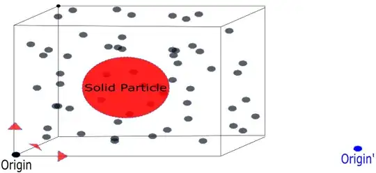

Suppose we have a solid particle suspended inside a fluid such as an ideal gas, as shown in the following picture: enter image description here
Our system is the solid particle and the environment is the gas (which acts as a heat bath). Our frame of reference is attached on the edge of the container (shown with black color, ignore the other origin for the moment).
The energy of the solid particle, composed of $N$ atoms, in this frame of reference is (for sake of simplicity we assume we have a monoatomic solid and neglect the potential energy terms):

I am giving below a gif from Wikipedia which can help visualizing the process. In this gif the yellow "ball" is a dust particle.
Frame of reference and net velocity
Suppose now that we describe our system based on the origin with blue color, which happens to move relatively to the container (and also to the gas). This means that now $\langle V_\mathrm{cm} \rangle \neq 0$. This is not a proper frame of reference to apply statistical mechanics since if the relative velocity is increased, the temperature of the solid particle will increase which doesn't make sense. Is that also correct?
