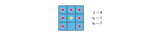

It is better to think ignorance rather than information and think of "ignorance" as the number of possibilities under current knowledge. To idealize your initial setup, suppose the left box contains $L$ volume elements, and somewhere in those elements we have $n_1$ K+ ions and $n_2$ Na+ ions. The remaining $v=L-n_1-n_2$ elements are empty. Given only this prior knowledge about the system, what is its entropy?

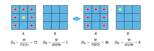

enter image description here We know the number of ions of each type and the size of the box but we don't know where the ions are in the box. The number of possibilities in this simple case is given by the multinomial factor: $$\Omega(L,n_1,n_2) = \frac{L!}{n_1!n_2! v!}$$ This is our "ignorance", the number of possibilities given what we know about the system. Entropy is its logarithm: $$S = \ln \Omega$$ We can now use this method to calculate before and after entropies. Suppose the yellow ion passes through to a compartment of size $L'$, which let's say was initially empty:
We confirm that the second law applies: $$\ln\Omega_{A'}+\ln\Omega_{B'} > \ln\Omega_A+\ln\Omega_B$$
In all cases the issue is ignorance: based on the information we possess (size of the box, number of ions of each kind) we cannot be certain where each ion sits. We can only give a probability for each possible outcome.
