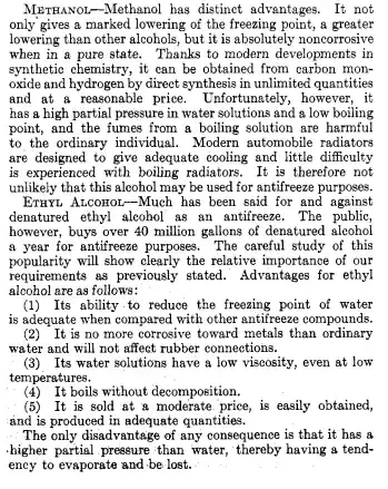

Recently while reading the literature that ethyl alcohol has a higher partial pressure than water, thereby having a tendency to evaporate and be lost.'
My understanding is that the higher the partial pressure, the harder it is to evaporate, but it is written here that there is a tendency to evaporate, I would like to ask the possible reason.

Your source (which is screeenshotted but not linked) seems to confuse these terms. “Vapor pressure” is a property of a material. “Partial pressure” is a property of your environment. You can reduce the partial pressure of ethanol above a surface by replacing the air there with fresh, alcohol-free air from outside; the ethanol will then evaporate until the vapor above the surface is saturated.
