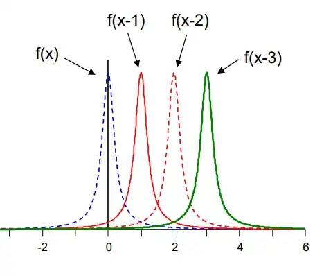

What is a wave? In the mathematical sense, a wave is any function that moves. To displace any function $f(x)$ to the right, just change its argument from $x$ to $x-x_0$, where $x_0$ is a positive number.
Wave
It includes all periodic phenomena discussed in the links you give.
