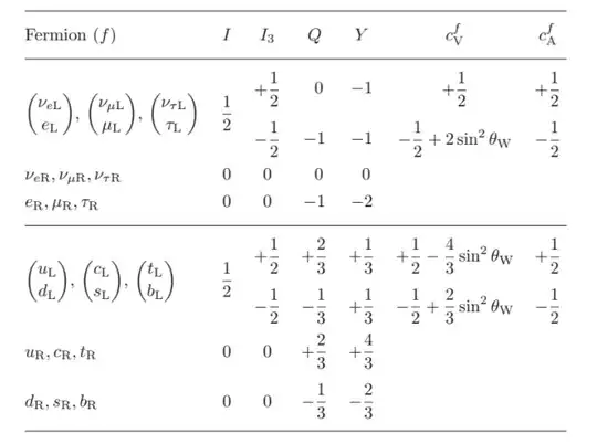

Addendum. The previous equation can be also written in the following terms: $$ g_{\rm{z}}J_\mu^Z = \frac{g_{\rm{w}}}{\cos \theta_W} \bar{u}\gamma_\mu \frac 1 2(c_V-c_A\gamma_5)u \qquad \operatorname{with} \qquad \begin{split} &c_V=c_A - 2Q\sin^2\theta_W\\ &c_A=I_3 \end{split} $$ If it's true that $Z^0$ boson also interacts with right-handed particles, and it is, then why in this table are the values of $c_V$ and $c_A$ with right-handed particles (neutrinos excluded) absent?

\begin{align} W^\pm\text{ vertex factor} &= \frac{-ig_W}{2\sqrt 2}\gamma^\mu \left(1-\gamma^5\right) \\ Z^0 \text{ vertex factor} &= \frac{-ig_Z}{2}\gamma^\mu \left(c_V^f - c_A^f\gamma^5\right) &\text{with } g_Z &= \frac{g_W}{\cos\theta_W} \end{align}
The projection operator which chooses left-chiral particles is $\left(1 - \gamma^5\right)$. So for particles with $c_V=c_A$ (that is, the neutrinos) the neutral current is maximally parity-violating, just like the charged current. But for the particles with $c_V\neq c_A$, the selection of one chirality is imperfect, and it is $\left(c_V - c_A\gamma^5\right)$ which includes some of the wrong-chirality state in the interaction.
You should be able to write $g_L,g_R$ in terms of $c_V,c_A$ by doing algebra on the two expressions for $g_zJ^z_\mu$ in your question.
I don't know why your picture of a table is typeset as if $c_V,c_A$ are attached to one chirality. That choice may or may not be explained in the text surrounding that table in your source. It might also be that aligning things in LaTeX tables is hard, and eventually normal people give up on some of their dreams.
