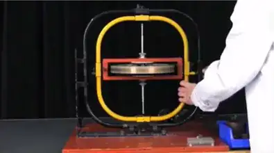

The gimbal mounted gyro that you are referring to:
Demonstration gyroscope, gimballed
That particular demonstration gyro has been in use for a long time, I've seen it in different videos. Back when I created a diagram I used the same color scheme for the two gimbal rings:
Diagram of gyroscope, gimballed
So:
Let's say the yellow frame is fitted with a torque sensing device, in such a way that when the yellow frame tends to swivel the torque sensor tells you the magnitude of the torque.
There is a relation between rate-of-precession and torque.
For the orientation of the gyro wheel as depicted in the diagram:
When a small weight is added such that there is a down-pitching torque there is a corresponding rate of precession (and direction of precession) such that the precessing motion gives a tendency to pitch up that offsets the downward torque from the added weight.
The larger the mass of the added weight the faster the precessing motion needs to be in order to offset the torque from the added weight.
That relation works the other way round too:
given a particular angular velocity of the gyro wheel there will be a specific added weight such that the corresponding precession rate is one revolution every ten seconds.
When you make the gyro wheel pitch then in response to that motion the gyro wheel tends to swivel. If you make the angular velocity of the pitching motion such that it corresponds to one revolution per ten seconds then the tendency to swivel will correspond to the same torque that corresponds to a precession rate of one revolution per ten seconds.
I define three axes:
  • Roll axis - the gyroscope wheel spins around the roll axis.
  • Pitch axis - motion of the red frame. As you can see, the gimbal mounting ensures the pitch axis is perpendicular to the roll axis.
  • Swivel axis - motion of the yellow frame.
When the gyro wheel (in the orientation depicted in the diagram) is being turned around the swivel axis then in response the gyro wheel will go to pitching motion.
Likewise: When the gyro wheel is being turned around the pitch axis then in response the gyro wheel will go to swiveling motion.
About the initial torque: in order to start motion a torque must be applied. It is the motion that elicits the gyroscopic response.
Gyroscopic response is what sustains nutation:
Pitching down elicits swiviling motion, that swiveling motion elicits pitching up, pitching up elicits swiveling motion in the other direction, and that brings the cycle back to pitching down.
Cleonis
