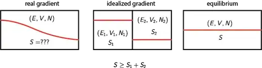

Equilibrium thermodynamics employs a special idealization to deal with non equilibrium states. It goes as follows:
Take a box with energy $E$, volume $V$ and number of particles $N$. The system is internal equilibrium. Next, divide it into two parts $(E_1,V_1,N_1)$ and $(E_2, V_2,N_2)$, with $E_1+E_2=E$, $V_1+V_2=V$ and $N_1+N_2=N$. Each part is internal equilibrium but not necessarily in equilibrium with each other. Entropy is defined in both parts and in the unpartitioned box. Thermodynamics says $$ S(E,V,N) \geq S(E_1,V_1,N_1)+S(E_2,V_2,N_2) $$ If this holds as an exact equality we say that the parts and the whole are in equilibrium: if we remove the partition that divides the box we will observe no macroscopic changes. If it holds as an inequality thenthe parts represent a non equilibrium partitioning of the whole: removing the partition will result in macroscopic change of state.
In this construction the "non-equilibrium state" is viewed as a partitioning into parts that are in internal equilibrium. We then compare the partitioned state to the equilibrium state of the whole.
Themis
