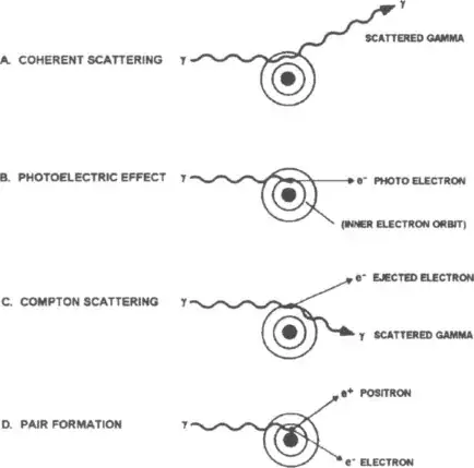

The energy of UV light 400-200nm is about 3-6 eV (electron volts). Gamma rays if produced by nuclear processes are between several hundred thousand eV and about 8 million eV. The energy spectrum of gamma ray bursts are somewhere between 100 and 5000 keV. Both UV and gamma rays are electromagnetic waves, but the UV absorption is primarily by exciting an electron from a lower energy level to a higher energy level which in a glass or semiconductor usually means from a valance band to a conduction band. In the glass, or insulator we don't usually think of them being conductive, because electrons are not thermally excited to the higher band.
In the case of gamma rays you can have more interactions.
Absorption of Nuclear radiation CHOPPIN et a.

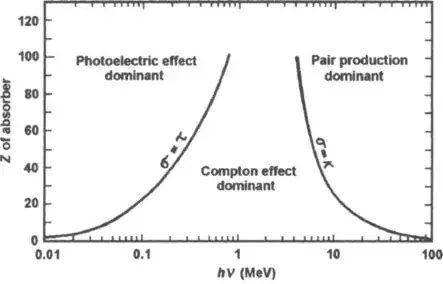

And if you look at the absorption as a function of energy
gamma ray absorption vs Energy
You can see for the higher energy like from your gamma ray burst is pair production. So in that since UV and Gamma Ray absorption will have different mechanisms. The high energy gamma ray as it interacts will matter will produce an ionization trail. This can kill electronic devices, damage DNA, etc.
