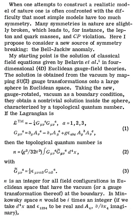

In Symmetry Breaking through Bell-Jackiw Anomalies G. 't Hooft, Phys. Rev. Lett. 37, 8 – Published 5 July 1976,
't Hooft said that the topological quantum number $n$
$n$ is an integer for all field configuration in Euclidean space that have the vacuum (or a gauge transformation thereof) at the boundary.
I understand this $n$ is a quantized Euclidean soliton number.
But what does he mean to say "the vacuum (or a gauge transformation thereof) at the boundary"?
  • What is the vacuum at the boundary ?
  • What is the gauge transformation at the boundary ?
By `vacuum' he means a vanishing gauge field $A$ and by gauge transformation thereof he means some arbitrary $A$ which is related to the vanishing configuration by a non-Abelian gauge transformation. i.e. the formula for $A$ is something like (there are various conventions), $$A_\mu=i U^\dagger\partial_\mu U.$$ where $U$ is a Euclidean spacetime dependent $SU(2)$ matrix.
The boundary of 4D Euclidean space is a 3-sphere, and mappings of the 3-sphere to $SU(2)$ break up into homotopy classes indexed by the integer $n$ in formula (2).
