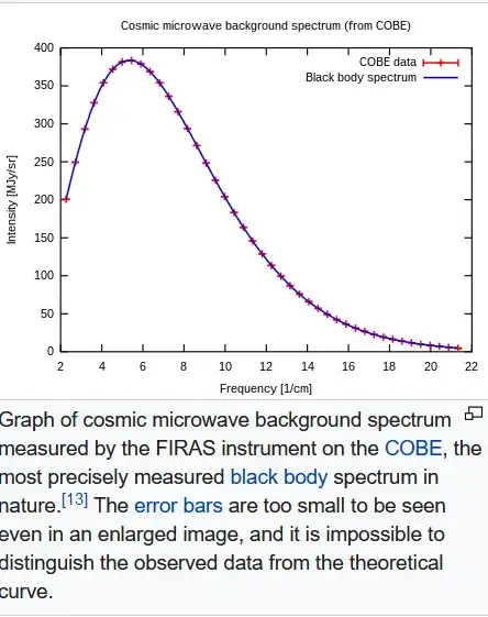

What is the cosmic microwave background radiation "temperature"?
It is the value of temperature found when fitting a black body radiation curve to its spectrum of photons.
cmb
The perfect fit leads to the present cosmological model's hypothesis that it is the result of the loss of energy of the original spectrum from the decoupling of radiation from matter in the Big Bang expansion.
So the temperature of the CMB reflects the kinetic energies of the particles in the plasma interacting at the time the radiation decoupled.
In an analogous analysis, the measured spectrum of cosmic neutrinos will have information about the temperature they were produced in the history of the universe. If interested further see this. .
So the temperature of a radiation refers to the black body fit temperature of the particles that produced it.
