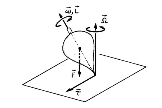

Consider the following symmetric spinning top with a fixed point on the horizontal surface.
Spinning Top
I have two questions concerning its motion:
  • let $\underline{\Omega}$ denote the precession angular velocity, that is, the angular velocity of the reference frame of the spinning top with respect to the inertial reference frame of the laboratory, then, applying the second cardinal equation and Poisson theorem yields: $$ \underline{\Omega} \times \underline{P_c} = \underline{r_c} \times M\underline{g} $$ where $\underline{P_c}$ represents the angular momentum with respect to the center of mass and $\underline{r_c}$ represents the position of the center of mass with respect to the fixed point; my question is how do we find out that $\underline{\Omega}$ must be directed vertically as in the above figure, since actually infinitely many vectors satisfy the previous relation?
  • assuming we have demonstrated that the spinning top follows a precession around the vertical axis, then, in that case, the center of mass is also rotating around such axis, therefore it should have a centripetal acceleration but what is the force responsible for it? (I thought about friction on the fixed point but the fact is that in any reference I have found friction is never talked about)
As always, any comment on answer is highly appreciated! Also, let me know if I can explain myself in a clearer way!
Matteo Menghini
  • 402
Let's start with your first question. You are right that an infinite number of vectors satisfy this equation, and in fact you could think about the top as instantaneously rotating about them (like in rolling without slipping). However, once we apply the condition that our torque must stay $r_c \times Mg$ through the whole rotation we see that the only case that physically keeps this condition is going to be rotating about the z axis as every other rotation involves some change in z value which would change our gravitational force which we assume is constant when we look at precession so we must have a constant z value and thus $\Omega$ points in the $\hat{z}$ direction (if you are interested in the case where we look at a changing z Taylor Classical Mechanics has a good section on nutation). $$$$ For your second question we can look at it in two ways. The first is from a physics problem perspective which just lets us say that there is some constraint force acting at that point to keep the tops tip from moving. However, we can also look at this from the point of view of what actually happens when you spin a top, and the answer to this is its going to be friction keeping the top tip in place (although it might move depending on the top and what you spin it on).
The answers are:
  • there is no single vertical $\Omega$
  • it's usually friction, just as you mentioned

I think your equation $\Omega\wedge P_c=r_c\wedge Mg$ is not correct. The l.h.s. should be the derivative of the total angular momentum w.r.t. to point of contact with the floor, not w.r.t. the center of mass.
