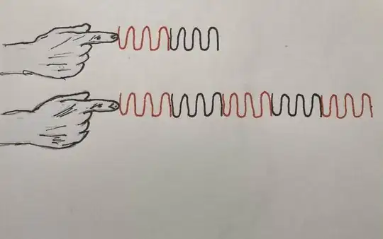

The best way to visualize inertia is to imagine all the fundamental particles in a mass as individual springs pushing against each other. When you push on one side of a mass, the force will work its way through every individual particle. Each particle also pushes back and when you push harder more springs push back. When pushing at a constant velocity, the springs will eventually expand back to normal as the resistance subsides, leaving the mass with a new velocity. Notice in the image that the mass with five particles would be more resistant than the mass with two particles.
