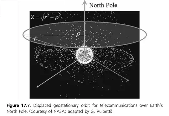

The accepted answer by udiboy is completely right; however theoretically it is not only gravity that acts on a satellite, but also light pressure from the Sun and Earth. Given a sufficiently light and large solar sail (implausible at the current technological level), it is possible to counteract acceleration due to gravity and enter a totally non-Keplerian orbit above one of the poles. This way the (mega) satellite will always stay illuminated.
fig17.7
For the displaced GSO in the figure above (numbers from Vulpetti et al. book of 2008, p.214):
  • Sailcraft elevation at North Pole: 11 degrees (not perfect, but acceptable in fair weather)
  • Orbit displacement ($Z$): $2.211 R_{Earth}$
  • Orbit radius ($\rho$): $6.2300 R_{Earth}$
  • Sail distance ($r$): $6.6107 R_{Earth}$
  • Lightness numbers: $\lambda_{Sun} = 12.65 ; \lambda_{Earth} = 0.334$
  • Sailcraft sail loading (mass/usable sail area): $\sigma = 0.1215 \frac{g}{m^2}$
To put things in perspective, a perfectly reflecting sail at 1 AU from the Sun (i.e. near the Earth) gets $9 \frac{N}{km^2}$ from solar pressure (puny nine Newtons per sq.km of surface).
The practical value of such a satellite is limited:
  • It will be difficult to maneuver (we haven't mastered attitude control for flexible rigs yet), and a sufficiently grave mistake will likely lead to a spectacular re-entry.
  • At such a large scale it will contribute to global warming and Arctic/Antarctic ice melting.
  • Payload will be minuscule. Basically, anything else than the sail will be a problem, so barring huge advances in nanotechnology there'll be no decent thermal control etc.
