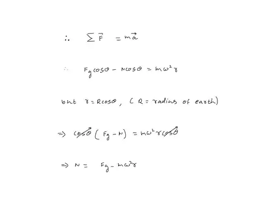

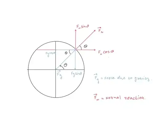

My concern here is that, if you were to calculate the apparent weight of an object due to earth's rotation at the equator, most text books use centripetal force and it works totally fine, but when it comes to any other point on the surface of the earth that is at an angle, the textbooks switch to centrifugal force. Is it not possible to figure out the apparent weight using centripetal forces? I tried it out but my answer is completely wrongenter image description here
The correct answer is dependent on the angle theta
It would be great if someone helped me out with this. Thanks!

You are implicitly assuming that the normal force and the force due to gravity act in parallel and opposite directions. This cannot be correct, except at the equator, since their resultant (which is the centripetal force) must be perpendicular to the Earth’s axis of rotation.
So either the normal force is not radial (i.e. the Earth is not spherical) or you must include friction in your forces. If you assume the Earth is a perfect sphere and is smooth then everything slides towards the equator, and your incorrect assumption is that an object not at the equator is in equilibrium.

First: using forces is superfluous. Stick to accelerations.
If you have a perfect sphere ($R$) rotating at $\vec\omega$, then there is a (Newton's Law) gravitational field that always points radially:
$$ \vec a_g(\theta) = -a_g\hat r$$
where $\theta$ is the geocentric latitude.
There's also a centrifugal acceleration:
$$ \vec a_c(\theta) = \omega^2 R\cos(\theta)\hat x$$
Then use
$$\hat x(\theta) = \cos(\theta)\hat r - \sin(\theta)\hat\theta$$
to add them:
$$\vec a = \vec a_g + \vec a_c $$ $$\vec a = -a_g\hat r + \omega^2 R\cos(\theta)[\cos(\theta)\hat r - \sin(\theta)\hat\theta] $$
$$\vec a = -(a_g-\omega^2R\cos^2\theta)\hat r - 2\omega^2R\sin( 2\theta)\hat\theta $$
You use spherical coordinates so the change to pure Newtonian gravity shows a reduction in central attraction in the radial direction, and a vertical deflection give by the $\hat\theta$ term

The rotating Earth
The rotating Earth is in hydrostatic equilibrium. At the Equator the distance to the geometric center of the Earth is larger than at the poles. The difference is about 21 kilometers.
The atmosphere of the Earth has the same thickness everywhere. That is, the atmosphere does not have a tendency to all flow to the Equator.
As mentioned earlier, at the Equator the distance to the Earth's geometric center is larger than at the poles. So: from the Equator to the poles is a downhill slope, just as the surface of a liquid mirror telescope is a downhill slope.
The effect is that at every latitude the effective gravitational effect is perpendicular to the local surface.
At the Equator objects have less weight than on other latitudes. To co-rotate with the Earth requires centripetal acceleration. Providing that centripetal acceleration goes at the expense of the true gravity.
The same effect is at play on all other latitudes, but you have to do a decomposition.
The required centripetal acceleration is perpendicular to the Earth's axis. You decompose that into a component parallel to the local surface, and a component perpendicular to the local surface.
For the weight effect only the component perpendicular to the local surface counts.
