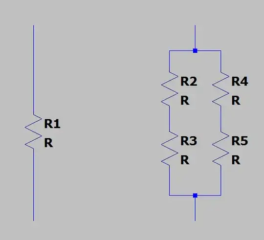

However, by increasing the volume of the resistor, one can reduce the noise index: Below in Fig. 1, both resistances are equal to $R$, but the right assembly uses four identical resistors each contributing uncorrelated noise. It can be shown, that the 4 resistor assembly has a twice lower total excess noise and thus lower noise index. Therefore, the resistance of the right side assembly can be defined twice more precise than the single resistor on the left side. By quadrupling the volume of the resistor and leaving everything else unchanged, the excess noise drops to half demonstrating the relation $n\propto V^{-1/2}$.

enter image description here Figure 1: Using 4 identical resistors, one can make an assembly with the same resistance, but twice lower excess noise

  3. You start with one resistor, then 4, then 16, then 48 resistors as you try to extend the method... and the current going through an individual resistor is 1/2, then 1/4, then 1/8 and corresponding voltage drops.
  4. Your assumption is that the network of resistors are all identical, but each would also have some variation.
