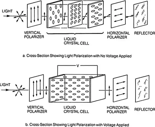

Currently, I am studying liquid crystal displays. I have studied that liquid crystals are used in LCD screens for controlling and rotating the plane of vibration of the incoming light. I didn't get the exact physics phenomenon behind it. Please elaborate more on it in a scientific way on the physics behind the behaviour of liquid crystals.
Enter image description here
The key physics is that liquid crystals shown in your diagram are birefringent material. This means that the polarization (orientation) of the light changes the effective index it sees.
In the case you are looking at OFF (a) the light is essentially guided by the helical/twisting nematic liquid crystals. The polarization follows the orientation of the liquid crystal if the helical pitch is much larger than the wavelength. The construction is usually done by applying rubbing on two substrates and then having them twisted at 90 degrees. The boundary conditions require that the liquid crystals line up with rubbed "grooves" along the plate so that when no electric field is applied the liquid crystals twist when going from one plate to another. For a mathematical treatment of the polarization "guiding" you can read Section 2.4.1.1 of the textbook Fundamentals of Liquid Crystals, 2nd Ed by Yang and Wu. I believe the first edition also has it at the same section. The Wikipedia article on it doesn't really describe the physics, but it has a nicer picture.
In the ON (b) state, a large voltage is applied so that all the liquid crystal molecules/directors line up. In this case, no polarization "guiding" is occurring so that the linear polarized light hits a perpendicular polarizer and is blocked.
If you are interested in the physics of how the liquid crystals are oriented and interplay of the elastic energies and electric fields, you can look up the Frank-Oseen Energy. For even more detail, you can look up the work by Pierre-Gilles de Gennes whose work in liquid crystals go him a Nobel Prize. To be honest, liquid crystals can be cumbersome and hard, so how much you want to dig will depend on what you need to do with it.
